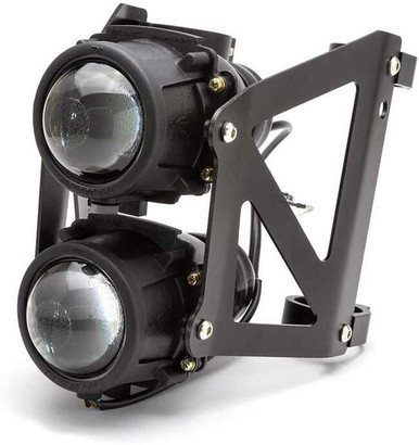

I'm thinking this headlight:
And mount it using this bracket:
It'll look nice :)
Kind of strange the product page doesn’t show the light output pattern. The reviews seem a bit contrived. Have you found videos to help? Keep in mind “Cafe” communities often seek cool factor and what neighboring “bikers” post on IG. Don’t be that guy, lol. Its certainly inexpensive.
Headlamps are a hard decision. The TVL headlamp is $1,180 and when I tried to upgrade the 2015 BMWGS1200R to LED, OEM it was $1,800.
If the headlamp does not cast the right light for your liking, go with auxiliary lights by:
Clearwater Lights LED Motorcycle Lights and Off-road Vehicle or
There are comparisons of both at https://advrider.com/f/threads/denali-d4-versus-clearwater-lights.1326733/
I went with the Denali DM 2.0 and they are working great. The photo is not the DM 2.0
