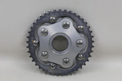

So these cush rubbers are inexpensive, but their design just doesn't last very long, being my second time replacing them in the last 2 years.
The newer 3rd gen hub looks eerily too much like the 1st gen hub I had on my F4, for MV to call this an improvement, rather than admitting it fixed their own mistakes.
But the cost of getting the "new" hub isn't worth the price for me.
$550 vs. $25 set of rubbers once a year...
Note:
The rubbers are MV specific, having their logo stamped on them.
I properly torqued the flange nut last time (200nm), but you can see it came off effortlessly. My only guess is as the rubbers crush laterally, the torque acts less on the flange. Maybe re-torque after 250 miles is in order? Will try and find out...

A lot of guys have gone to aftermarket ... similar to original (round dampers) that never had a problem. Probably a lot less than the genuine MV "new" parts.

I went ahead and snagged this today. Waaaayyy cheaper than from MV.
I remember seeing Gen 1 carriers needed a spacer to fit Gen 2.
This is from a 2020 F3. I can't tell by the photos if it has, or needs, a spacer?

Well I got my 2020 carrier, free shipping from Kiev, Ukraine...
NO fancy video this time, but I promise I left it in neutral for the entire job!
I prefer OEM whenever possible. And this design looks right, and worked well on my F4.
The circular cush rubbers don't sit as deep, and therefor don't mount anywhere near the hub.
The last carrier sat freakishly close, and evidence of rub was seen as the rubbers started to go bad. Thankfully, my hub wasn't damaged by this.
Only spent $140, not bad! Other options seemed to be around $500+...
