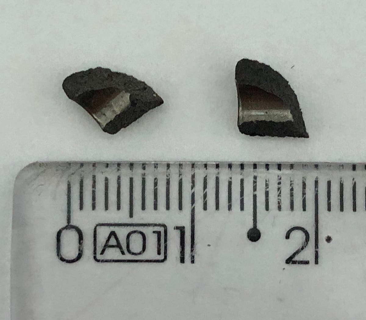

Disassembled air box and found those 2 pieces of metal inside air box.
Ruler is in Centimeters.

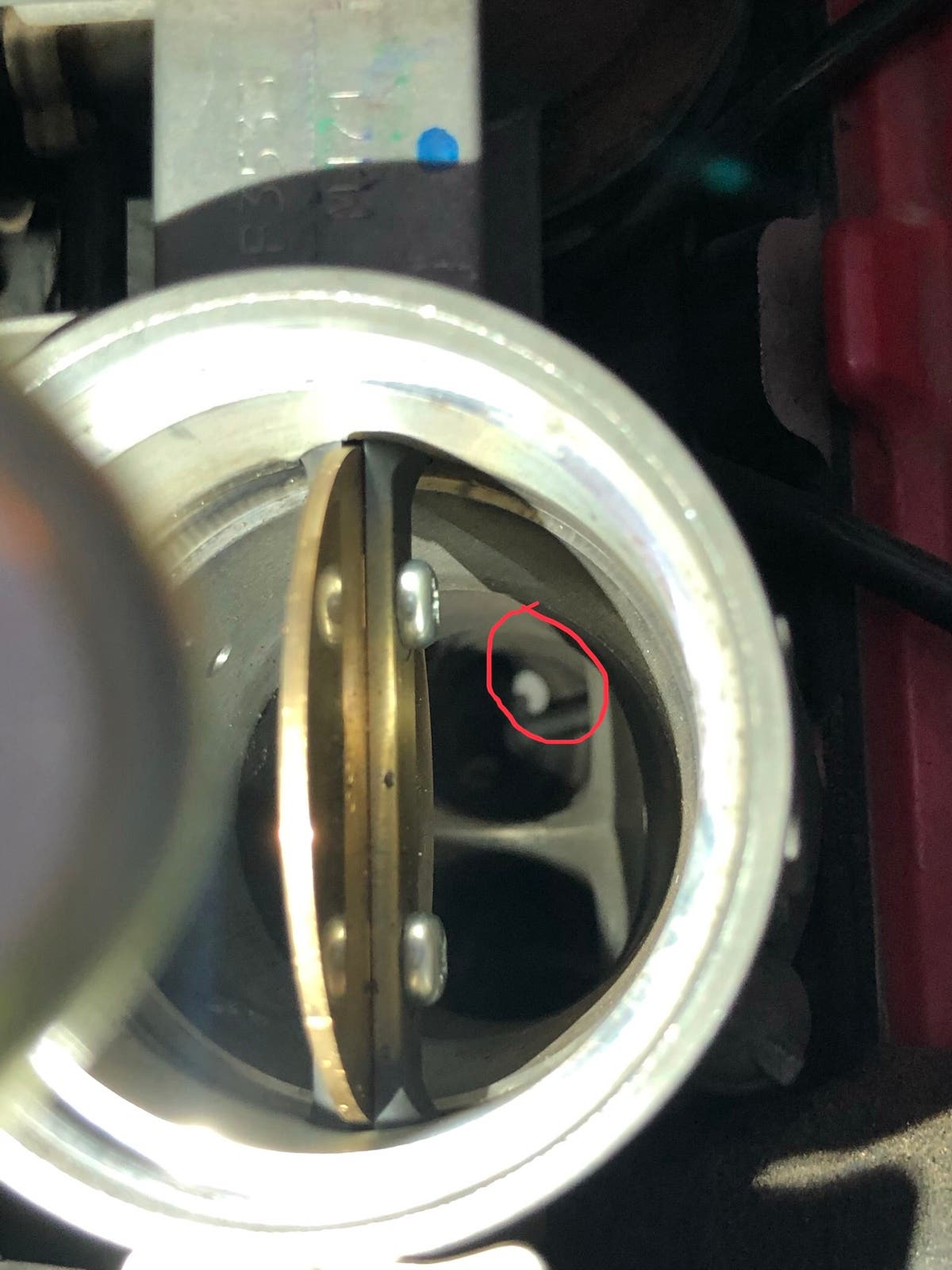

Also, looking through throttle bodies, I can see 2 more of those pieces on top of cylinder 4 intake valves.
And comparing what I see on other cylinders, it looks like the end tip of valve guides for cylinder 4 are also missing. Was not able to take a clear picture.
So, what are your thoughts and recommendation on this? I’m probably disassembling head to look further. Thinking of both valves and guides.
