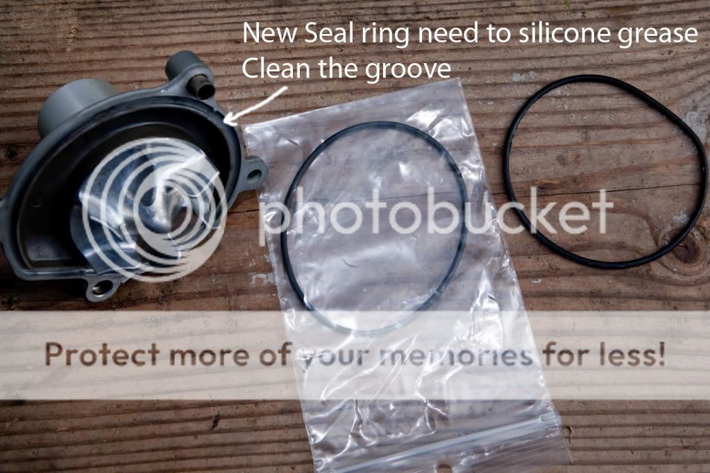

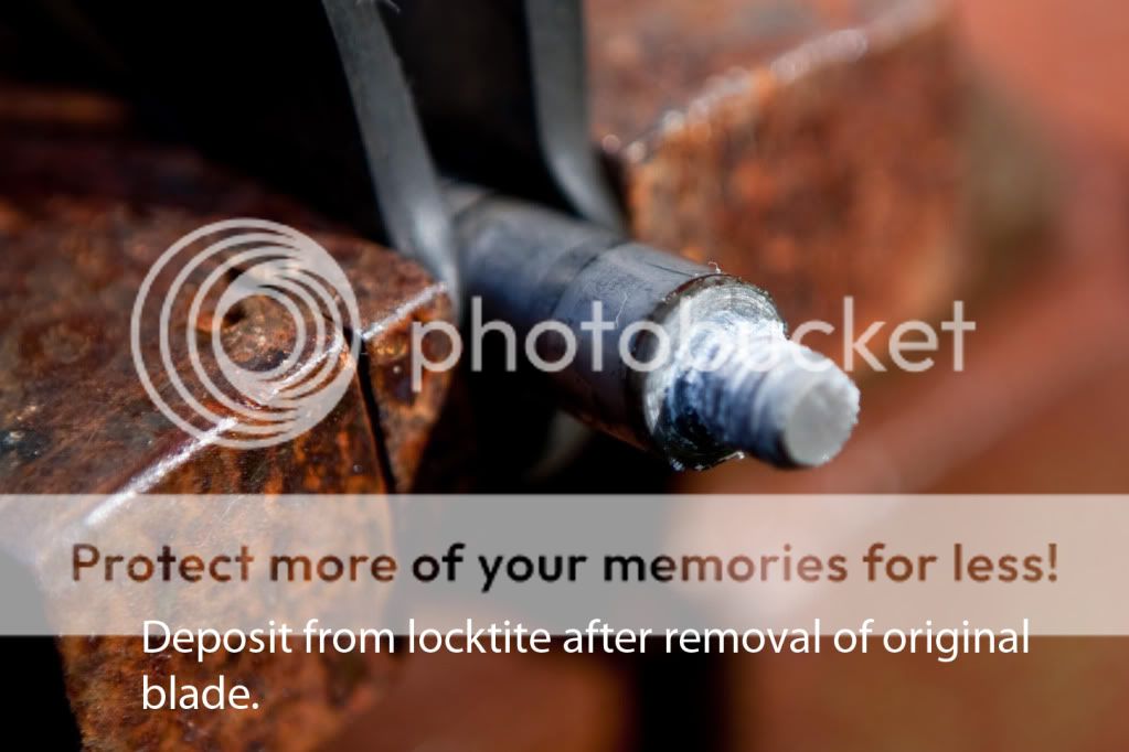

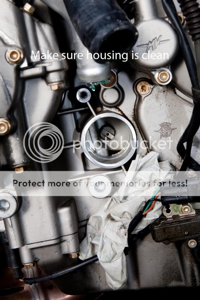

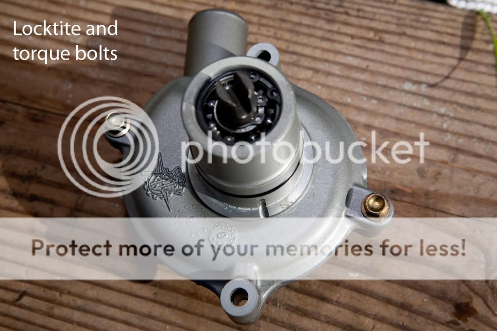

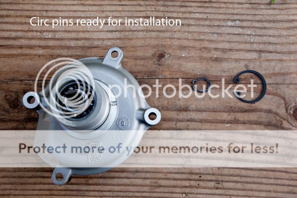

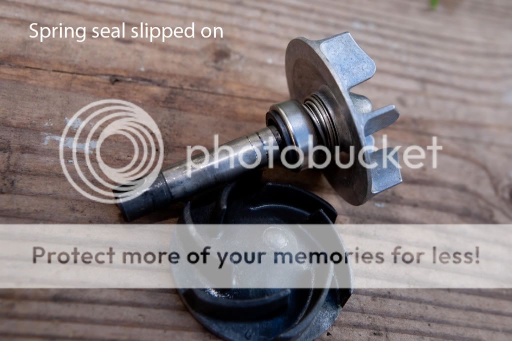

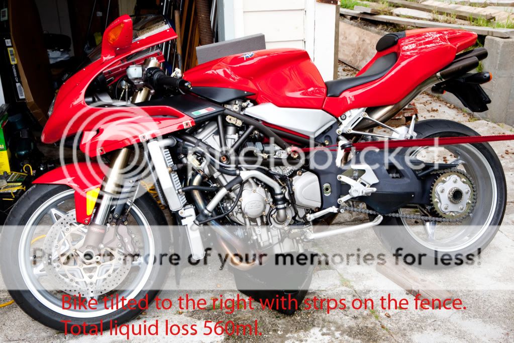

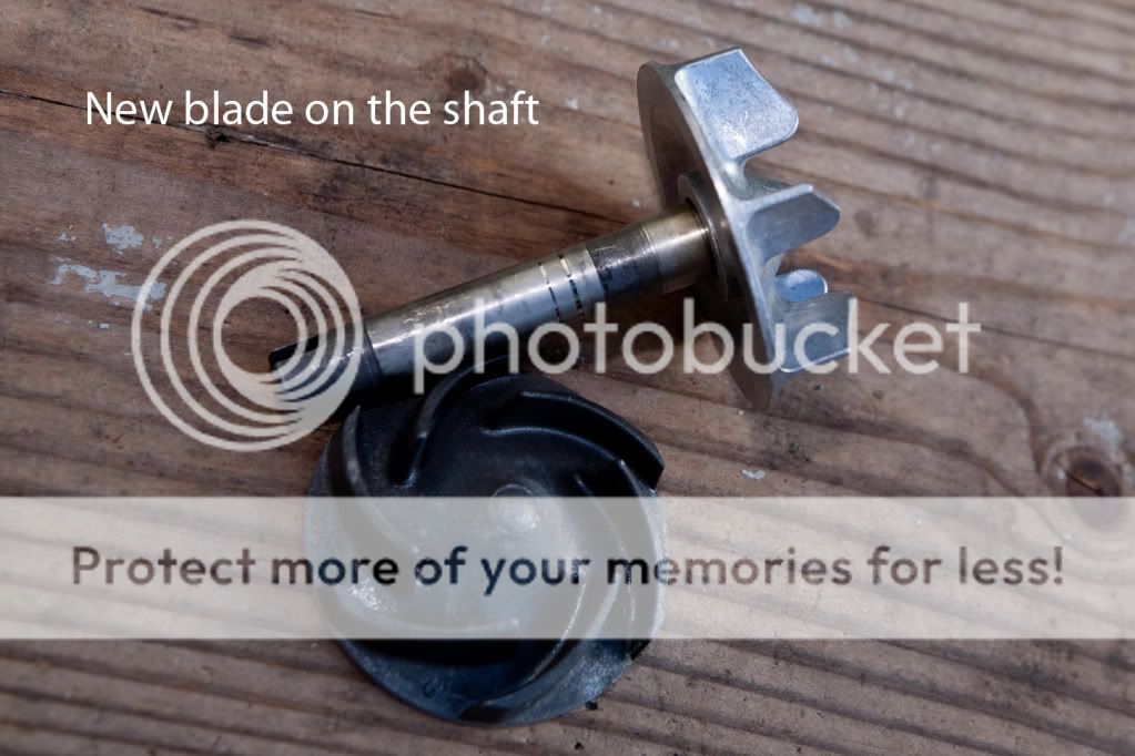

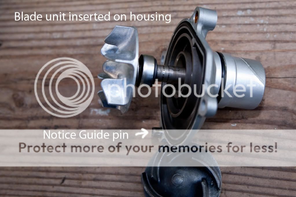

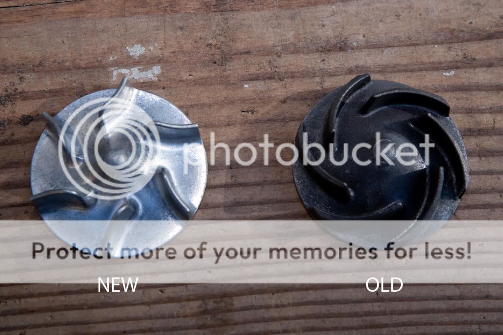

For running hot on my F4 I finally had enough and installed a new water pump with much hesitation on my mechanical ability but at end it worked out better than I expected.
Here we go!
I hope this will help some people that are mechanic challenged as I am.
Good Luck.
Have a cool ride.:f4:
