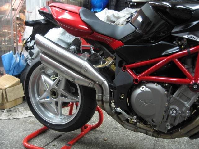

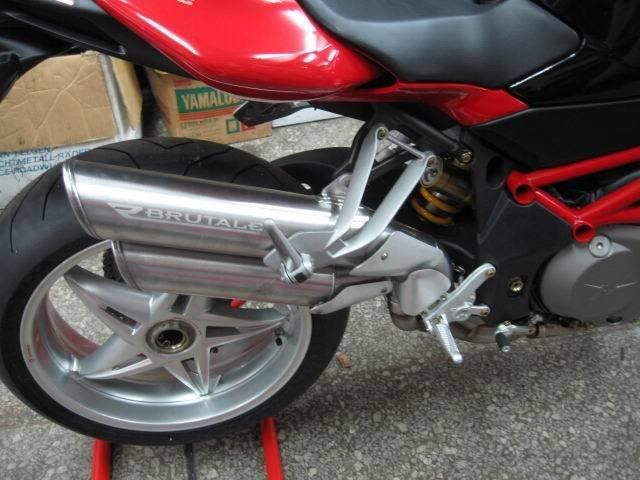

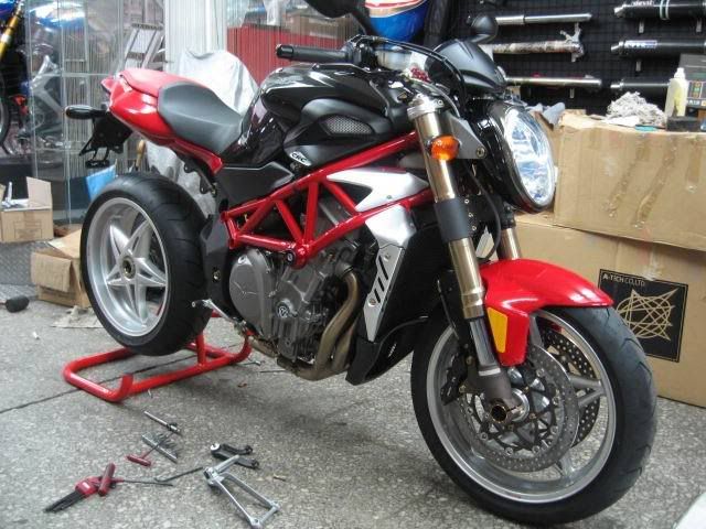

well, just an 910R exhaust now. :drummer:
Also made the throttle lighter, quicker, foot pegs lower, ride height raised, but sorry dont have any miles stock to compare it to. But it is NICE now! :highclap:

Hello, I see you also have the disease.....of mods...WELCOME to the nuts club.....
Nice job, I guess that you have to sort out the brakes to a radial setup and you will be really close to the R setup. :smoking:

u saying i should run it without a chip???
but i havnt run into the problems u speak of, never rode it stock, so i dont know.
but no smell or black residue yet. i do feel gas mileage was bad though, not even 100 miles on first fuel up.

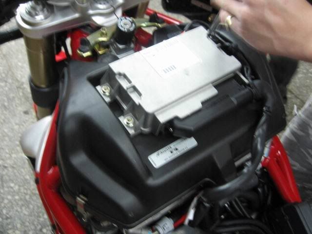

The problem is finding someone dedicated enough to get it right when they are trying to make a buck. It is a trial and error process; to adjust the potentiometer on the engine control module it must be removed from the bike (i.e. tank off). Then the module is re-installed, the bike fully warmed up and the CO sniffed. If it's wrong, you start over - remove tank, ECM etc until you get it right. :conveyer: A lot of techs out there being paid under the flat rate system will just throw the arms up and say "close enough". :ahhh: That's why I do it myself, I'm not trying to make a buck; I just want my bike to be right. If that means I spend all day adjusting, I can do what it takes.
Sorry for the hijack.
