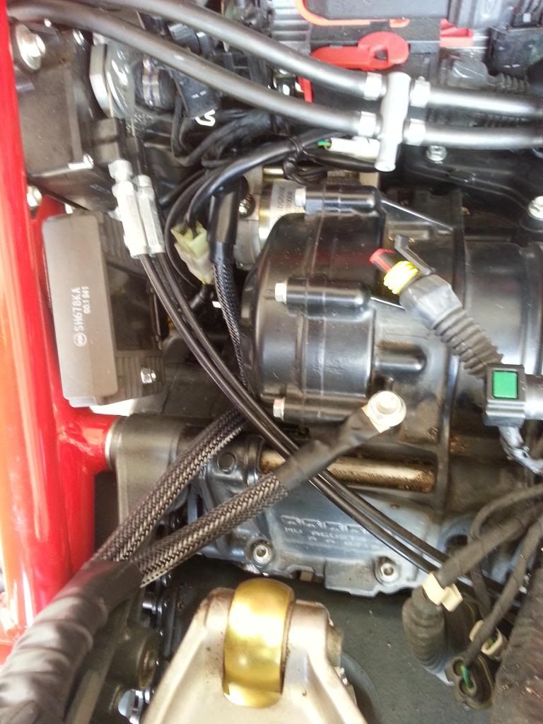

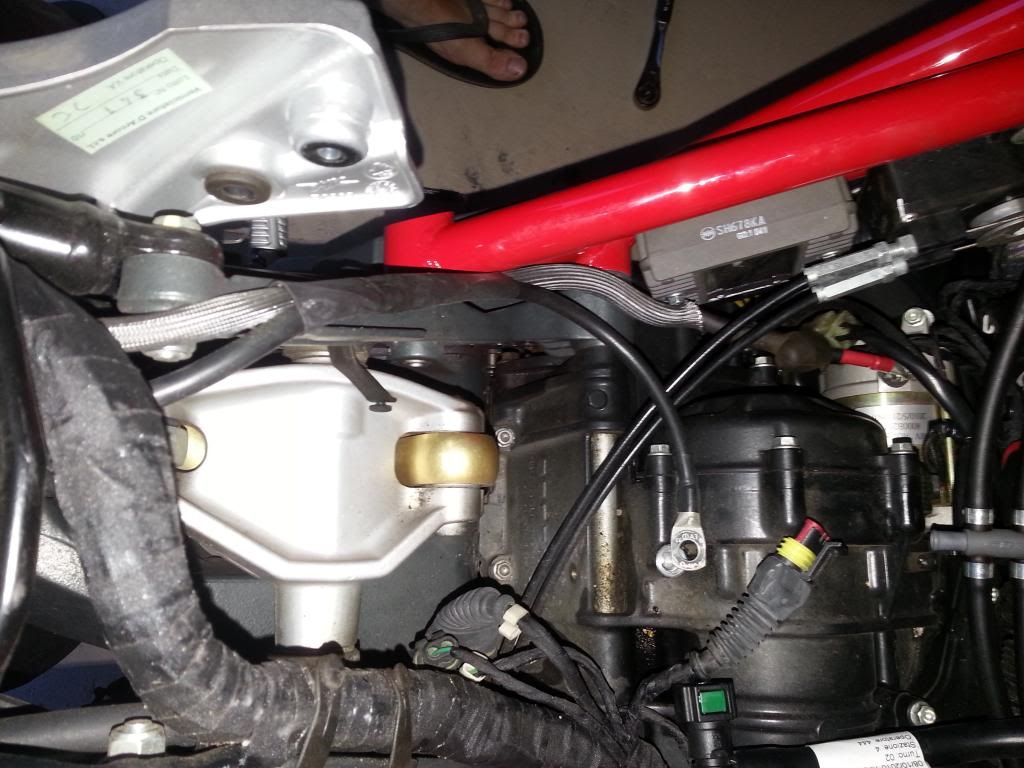

Motolectric cables routed to the starter and ground

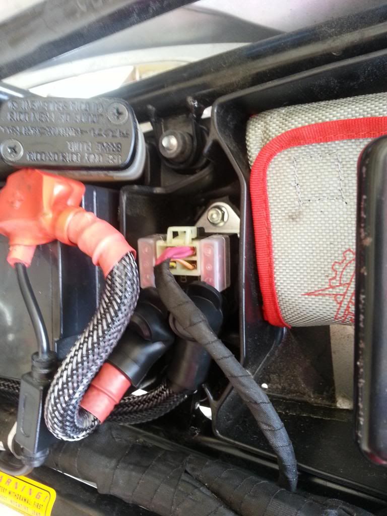

Battery to solenoid and starter to solenoid

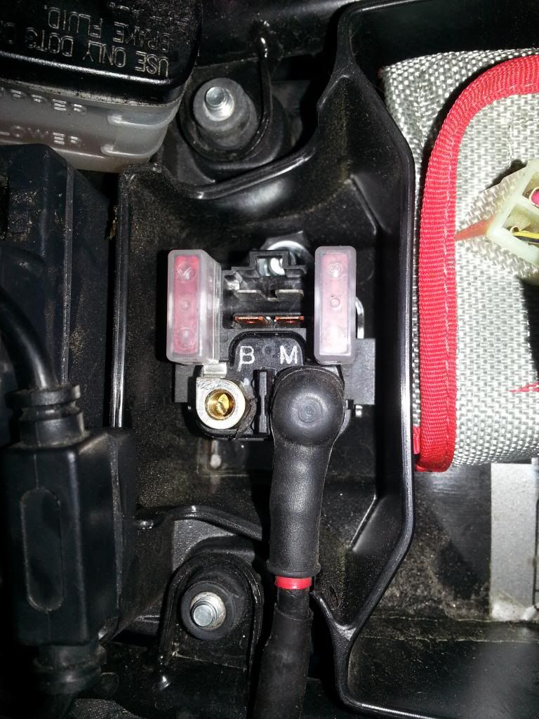

Step 3: Unbolt the two cables connected to the solenoid with the 8mm socket (Cable from the starter is still connected in the picture)
Step 4: Unbolt the cable to the ground with the 12mm socket if my memory serves me right (Bolt right in the middle of the picture)

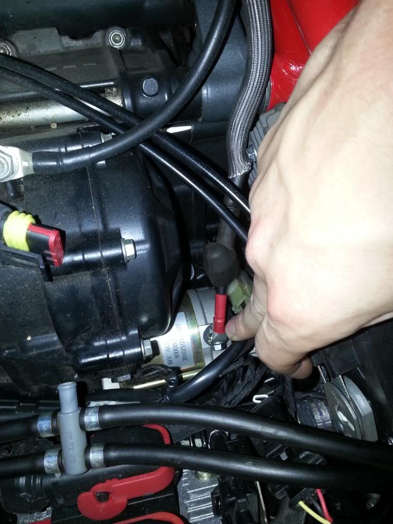

Step 5: Remove the cable connected to the starter. You will have to use the 8mm wrench for this one as the socket won't fit down in there. Be careful not to let the nut fall down in the motor bay like I did or you will be fishing it out with a magnet/tweezers. (The cable with the red heat shrink on it)

Step 7: Bolt on the new cables and apply the dielectric grease to the terminals. The only down side to the more robust cables is they are a little difficult to manipulate in some of the tight spots. Here is how some of my cables were routed.
Cable from the ground to the battery

Just a little hint when doing this pull out the clear plug on the soleniod so you can work on the cables safely,in otherwords you don't fry everything,push it back in when you have finished checking everything.
