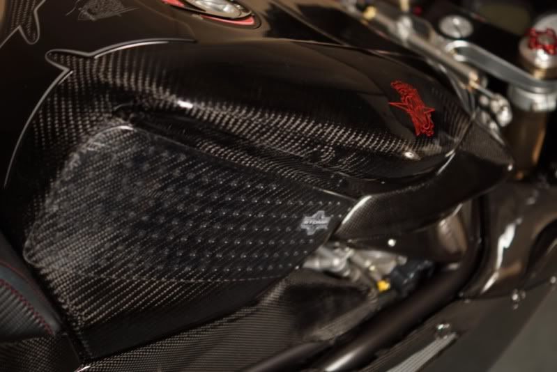

1,077 Posts
Lol got to love this I went and ordered EVERYTHING there was in carbon at beginning of last year the whole bike is cf apart from wheels couldn't use them here in uk with the roads as they are they just wouldn't last I even went and had bits made that I couldn't get threw JDS
She even got in to fast bikes mag in August just gone and is same months bike in there 2014 calender
