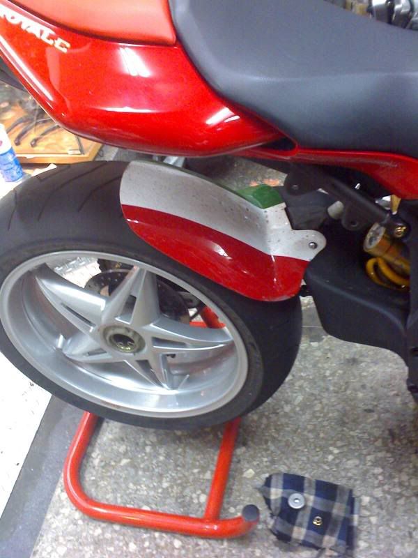

already @ 600 miles. So went in for a late night service, but almost my whole exhaust needs to come off to do a lube job????!! Joys of having an italian i guess. Also changed to carbon brake pads hoping to improve on the mediocre braking performance of the stock nissins. Almost all of my MV buddies have throw away their nissins in exchange for brembos, im being cheap with just the pads for now. Will report back on the carbon metallics soon.

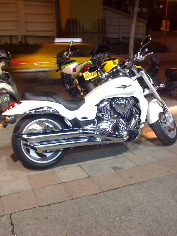

...........and a good friend took delivery of this huge a$$ mofo......and to think i almost got one too!! scary.........
