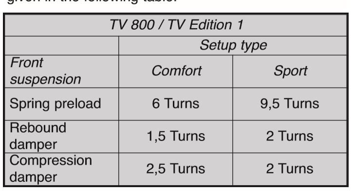

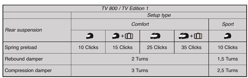

In general terms, you would need to increase spring pre-load both front and rear first for your weight from factory "comfort" settings. Then test and if not suitable start increasing both compression and rebound in the front and rear. I'm not sure if the owners manual suggests what weight their factory settings are for other than "comfort"?
All adjustments should be done gradually (small increments) and then tested. Find an isolated section of road where you notice the deficiency so that you can make changes and ride that same section to determine the impact of your adjustment and get it dialed in for how you ride and your ride environment.
If all this sounds like too much work then I'd suggest changing your settings to those referenced below for "sport" riding and start with the rear preload at 15 to 18 clicks. That should get you in the ball park pretty quickly.
