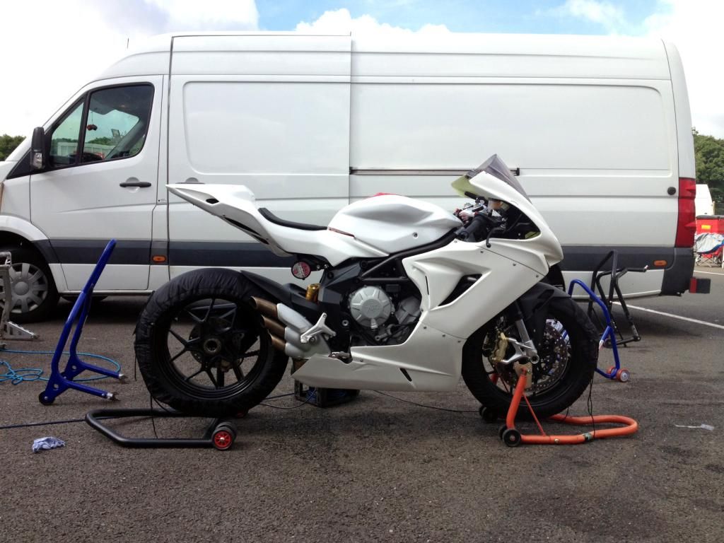

First off I fitted bodywork from ricambiweiss in germany with a bikesplast tank cover from the Czech Republic, as there's not much choice in the uk. The bodywork is really well made, I've had other stuff before that was a nightmare to fit, but this was ok with all holes marked out for drilling and reinforced kevlar tabs where fasteners go. It didn't come with any fasteners so I fitted Dzus 1/4 turn buttons with rivet-on backs and used rubber well nuts for the tail under tray. The under tray didn't have a hole for the rectifier so I've drilled a section out to keep it cool. All in it took a few nights in the garage to fit right, but I didn't get time to get it painted before I set off, so it's just white for now, eventually matte black with a few decals which I already have. Screen is a Puig DB tint. Nice to look at and nice to tuck-in behind.

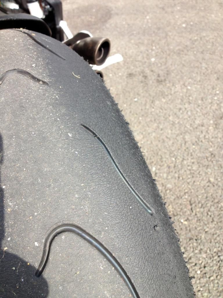

Now some good stuff…….handling, bloody brilliant, light, flickable and utterly sharp and totally stable when on it's side. The brakes were perfect and didn't fade all day, loads of power & feel, although the lever did start coming a little closer to the bar by the end of each 20 minute session, but nothing too bad at all. I have no idea how well the rear brake works, never used it. The bike did shake it's head a bit blasting down park straight and I'd had the "give me a damper" thoughts but as the day wore on I think I relaxed more and it never got to be a problem. For my needs the stock suspension is good, really impressed. The forks didn't bottom-out (I used a tie wrap to mark) and the standard sachs rear shock is really impressive. I'd been looking at upgrading this for track work, but looking at the wear on the rear tyre I think it'll be staying put. I've had posh suspension on track bikes for as long as I can remember, but at the pace I'm now riding this is perfect for me, it got hot but didn't fade. Well impressed with how the tyre wore:
[IMG][/IMG]
Tyres used were Metzeler racetec interact K1 front K2 rear, 29psi/27psi cold.
