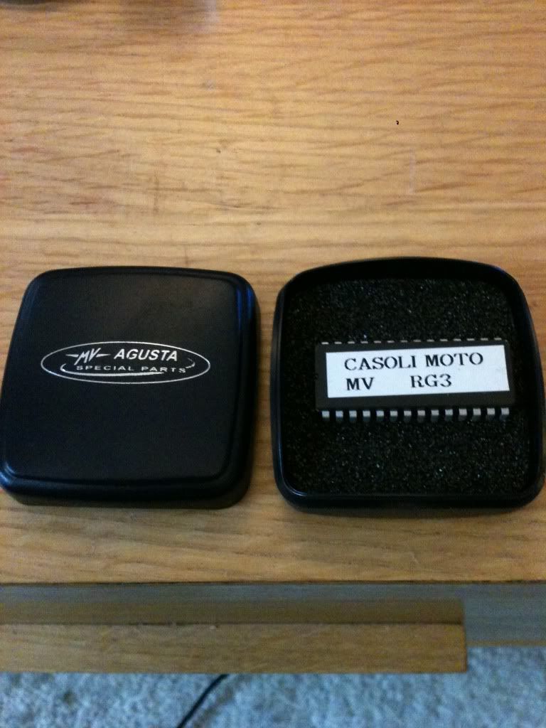

Hi Jimbo
Many thanks for the quick reply, that was my initial feeling on it. I'm fairly sure it was 14k rpm, although i have to admit, it was a very quick glance at the tacho!
Does your chip look like the following?
If so - im a little confused
Dale

Posts: 1,511
Nope, that is not an MV special parts chip. (But it is ina special parts plastic box) That chip was made by Casoli, an independent MV dealer a while back, think they have ceased trading now.
So not sure what they burned into your chip, if it was around 14k I would say that's a bit too high.
Edited to say does the chip have a paper stick-on label if so peel it back and see whats underneath.

Posts: 87
jimboF4
Hmmm, thats an interesting one then, i thought that might have been the case, but wasnt sure if they were burned by Casoli or not.... I know the cans and chip came out of an F4 750 that was being put back to standard to be sold. It seems to run bloody well though, at least the seat of pants dyno feels good.
As i said, it was a glance, but it was definitely over 13.5k
Dale
Edit - it does indeed have a paper label on it - but i've been on the beer since getting back in, so I dont fancy taking the ECU out at the moment
Deequeue is offline

Hi Dale,
Its always beer-o-clock somewhere, wise move to leave the alone for now. I had some dealings with Casoli, they had a shop in north London a while ago, were into Ducati and MV when they launched the F4 750. They used to offer gutting of original exhausts and chips to suit. Even done a big bore kit at one time. Have not heard of them for at least five years now.
Cheers jimbo

Try living in Newcastle mate, its always beer o'clock here
Sounds like I need to find someone with a Casoli chip and compare notes.

Standard chips read 13100 rev limit, the most I have seen on any 750 chip is 13300 from an evo or spr - same limit.

Hi Merc,
Thanks for the update - looks like i will be putting the standard chip back in for the moment, i dont really want to lunch the engine, after all.
Jimbo - the casoli chip doesnt have anything under the label.... did casoli produce a hot chip by any chance - for race bikes or something similar?
Meanwhile, anyone got a legit rg3 / silmoto chip for sale?
Dale
Edit - think it might be a good idea to actually check the standard chip to make sure the rev counter isnt over-reading too......

Just been checking the MV FAQ - apparently the 750 Senna had a 13,900 hard limit, with SPR headers and RG3 cans on.
