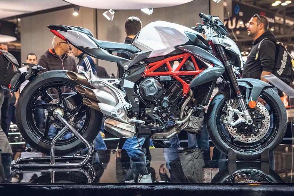

Just wondering if a F3 manifold with exhaust valve will fit on my 18 Brutale 800RR.
The pipes of the Euro 4 manifolds are pretty short and the pipe with the cat is much longer than on the Euro 3 models.
Imho not so good for performance....
Euro 3:
Euro 4:
I need the exhaust valve of the F3 as here in Germany the noise controls are very strikt - I'm sure the bike will be much too loud without the valve.
Euro 4 is 98 dB, Euro 3 is 103 dB.
The order numbers of QD are the same for the Euro 3 F3 and Brutale - so the fit of the Brutale and F3 manifold to the muffler should be the same. Order number for the Euro 4 QD is only different because they changed the mounts at the food pegs.
Did anybody try that manifold swap yet?

I would think it will work. The exhaust valve doesn't have that much affect on sound level. The cat and muffler are the largest noise suppressors.
The exhaust valve is also part of tuning (eliminates flat spots from valve timing overlap, exhaust pressure waves).
