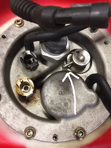

I have my Brutale 910 apart replacing the fuel fittings on the bottom of the tank due to a leakage. There is a small part that it looks like a vacuum hose is supposed to be connected to but there is no hose to be found. Anyone know what connects to the fitting in the picture below?

Nothing connects to the fuel pressure regulator......
Italians don't understand fueling.....

Thanks for the reply. That's what I was hoping for. Weird that nothing connects to that. Thanks!

If the dagos knew FI they'd connect manifold pressure to the pressure regulator and the spray pattern would always be the same
We can't connect manifold pressure to it because the map will be totally wrong
