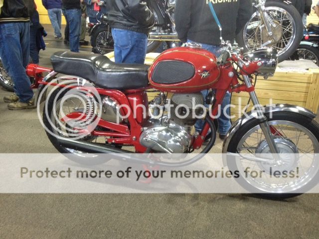

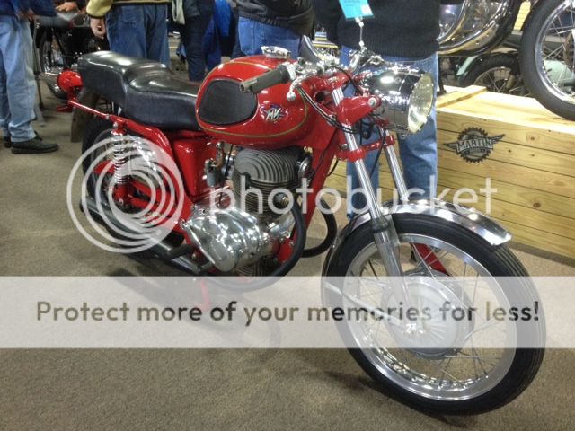

Hey JS Vermont, I recently went to a classic bike show and there was a 1969 250B, but it looks very different from what you show in the original post. In particular, I am looking at the frame, compared with these:
How certain are you that what you have is a 250B (or, that the one pictured here isn't)? I don't know squat about these , so I'm just trying to learn.
