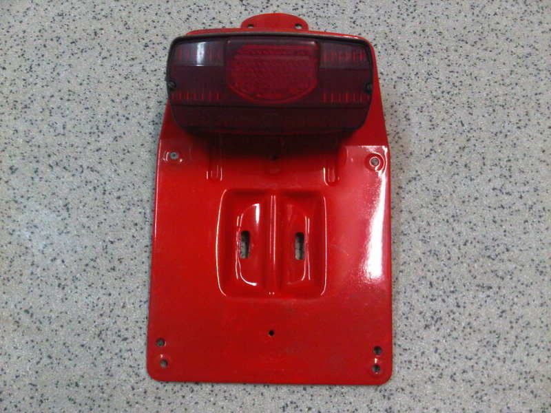

- I am trying to find the rear light that fits to my bike. I have another square rear light, I think that fits previous bikes:
About pictures, I have not lot of them... Here is one I took in the garage, near my F4S 750:
Here you can check how ugly is the rear light has my bike:

Yes, that looks like the tail-light unit from the earlier 750S, but it would suit your bike fine if you're not fussed about absolute originality. I wouldn't think many would know the difference! (I expect you'd find a round replacement at the guzzino site though).

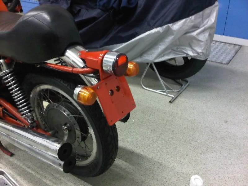

Finally I got a round rear light.
It makes great difference from the one installed on the bike:
The round one, already installed:
I have also changed the plastics of the turn lights. About them, I have seen a lot of MV's without them, and I can see that they are Gonelli - Made in Spain. Was it a difference for the spanish market?

Yes, that light looks a lot better gafas.
I've seen them with and without the turn signals too, but I don't think any left the factory with turn signals fitted. Maybe they were fitted by dealerships at the point of sale?
I have a set of 'lucas' type turn signals for mine (same as those fitted to early Laverda triples), and my bike even has a couple of 'idiot light' repeaters set into its cockpit support, but I have put them in a box for storage. I seem to manage OK on the roads without them, simply by being observant and being correctly positioned at all times.
