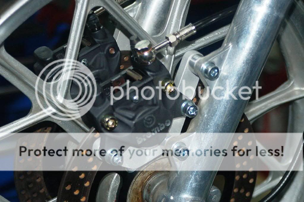

I've got a set of these Magni / Brembo kits on my 350, and they are worth upgrading to. As I ran into the same issues with my scarabs .
