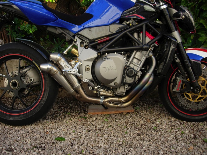

Gilles Tooling also fit (took that pic from here):
I do not know whose bike it is...
