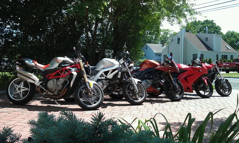

I took a 'family photo' this past weekend. The Brutale and the orange SV650 are mine, the silver SV650, Ninja 250 () and S4 are my brother's.

Nice family pic...I have a SV650 I do track days with...great bike!
