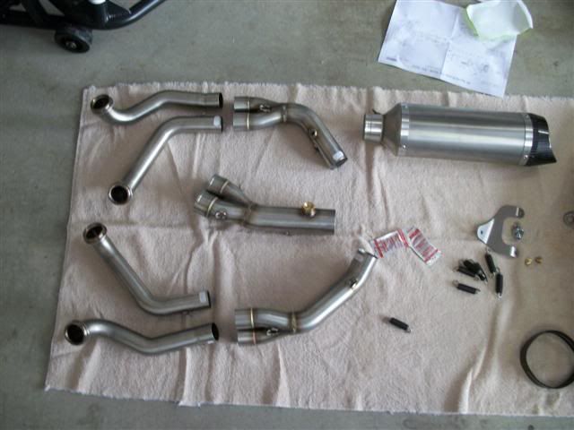

The saga began a couple of weeks ago when I decided to take the upcoming Monday off from work. I could spend the weekend installing the Arrow Thunder (from MotovationUSA) and Microtec ECU (from Chris at X-Bikes). Then on Sunday night, I’d ride up to have dinner with my parents—about 100 miles north of me here in San Diego—and stay the night. On Monday morning, at the recommendation of another board member, I had an appointment with Tige at CycleMall in Tustin for ECU mapping. What a great couple of days…I was totally pumped up.

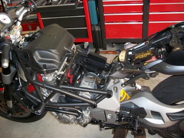

I started Saturday afternoon with tear down; this was the first time I had taken the bike apart this much. I bought the bike (2009 Brutale 1078RR) this past April and have loved every mile. The desire to fix the absolute crap low-end fueling (not to mention the sale of my Kawi 10r) led me to Chris and the Microtec. And while we’re at it, let’s go full Arrow exhaust!!

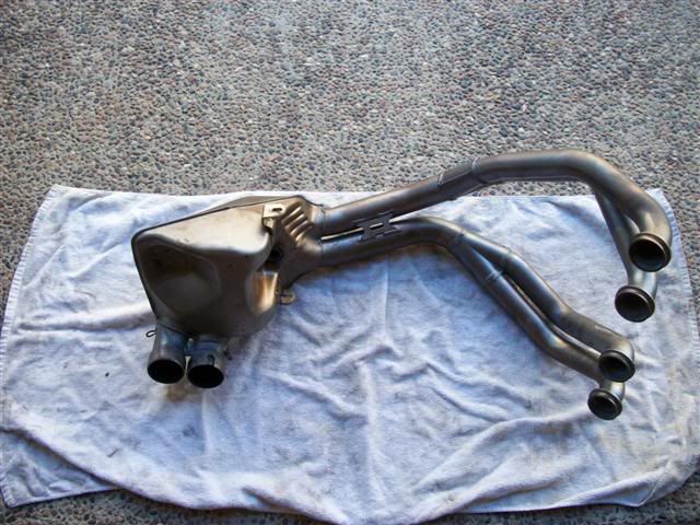

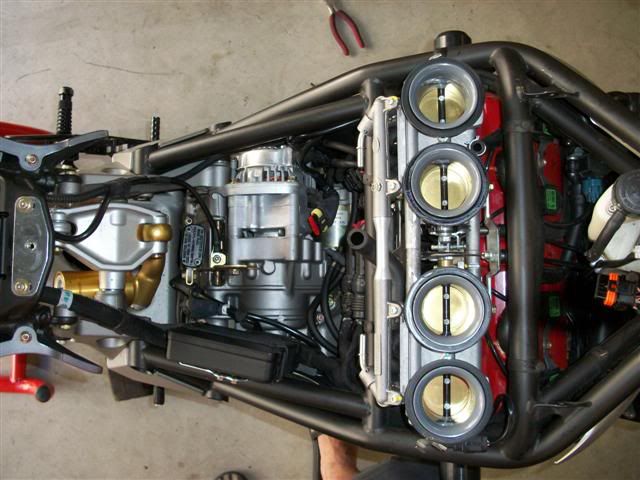

The removal of the old cans is pretty straightforward…it’s the one-piece header/cat that took a little extra thought, but not bad by any means. Once everything is unbolted, it is a tight fit to drop the whole header/cat with the radiator in the way (as documented in other posts). Next, I removed the gas tank and airbox; these were also pretty easy to do. I read prior posts which were very helpful and let me know what to expect. With the bike apart, I called it a night, ready to start install/reassembly early on Sunday.
I wish I could recall the member that suggested assembling the entire exhaust before cinching down the x-shaped header retainers…great tip. The Arrow was very easy to assemble and fit great. Piece of cake.
There were several wires to unplug to get out the ECU, but again well documented thanks to other post on this great board. The Microtec dropped right in; the location of the plug on the ECU for the USB adaptor slightly interferes with one of the electrical plugs, but this is only a minor deal. The major deal came after I plugged the Brutie into my computer to try out the fancy ECU.
