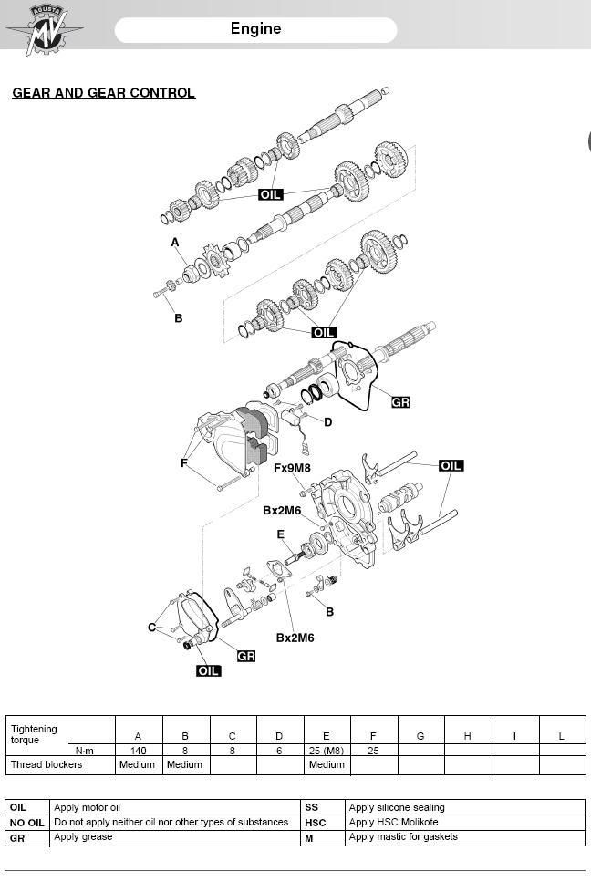

Did a search, but came up with nothing can someone tell what's the torque on the large nut that holdes the front sprocket?
thx!

I couldn't find it in the manual either, but I did have it in my track notes:
Front sprocket 140 Nm, 103 lb-ft.

Say is the counter shaft reverse threaded?
I'm nearly certain it's not. There should be enough threads sticking out past the nut to verify that.

just a little bit of the first thread - i wanted to be certain before i put a big pipe to it... could not impact it off... over 210nm applied on a wrench...

It would make sense to be regular right hand thread, as the acceleration forces would tend to tighten the nut. I can't remember any modern bikes with left side output that don't use right hand threads.
Left hand threads are usually only used where dominant forces would loosen a right handed thread (rear wheel nut as example).

So no luck! I used an expanding vice to apply pressure to the rear brake pedel, set in first gear, used and 32mm 6 point impact socket - 3 inch extension, 1/2 inch breaker bar 4 feet car jack pipe... Counter clock wise - all I managed to do is to turn the engine over...
My compressor is getting it's engine rebuild so no Ait tool, but I'm still using a Ingersoll-Rand W360 cordless that can deliver 360ft/lb in reverse... This f'er just won't come loose... I tried torch, wd40...
I noticed that the counter shaft sprocket nut is peened on two sides.
There aren't much threads to show which way...
Ideas? Bigger impact wrench?

Thing I don't understand is that MV recommends to use threadlock on that nut, doesn't make sense, none of my bikes had that in the past (jap and Triumphs) I can see why it's hard to remove.
You could try TIGHTENING it a tiny bit to break the threadlock before attempting to unscrew it.
It's a regular thread by the way
