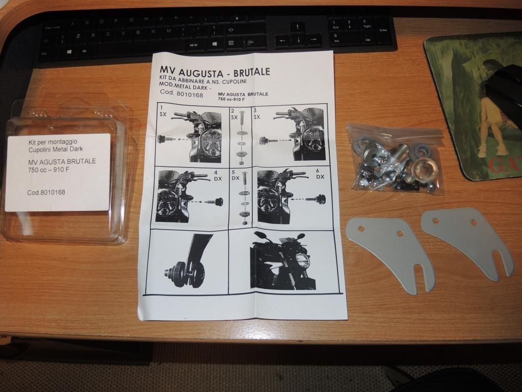

This is the correct kit for fitting the Biondi screen to the 750 Brutale. I sourced it from a supplier in the Netherlands. Compare it with the kit I got in the first post. The brackets are really poor but you do get the modified headlight bolts with the correct spacers and grommets.
I appreciate your offer Noel but I'm going to fabricate my own brackets out of 3mm alloy which will provide a sturdier mount and allow a greater range of adjustment.

instead of those horrid slots
go off the turn indicator mounts and mount some LED indicators on the
mount like in my picture
the rear most part of the fairing is ~8mm below the top of the M/C and
clutch reservoirs (not the tops) and ~4mm from the reservoirs
