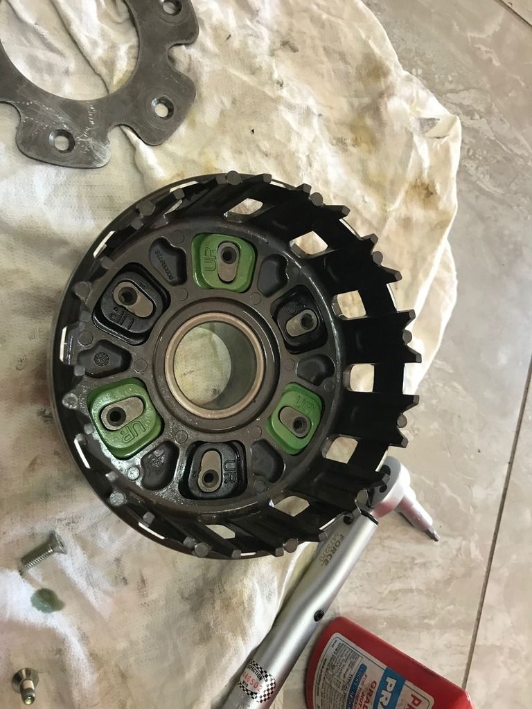

Alright, so I just replaced my clutch with the new hub and cush rubbers. The only dealer with the agency went bust last year so I ordered the parts myself from Evolutionbike (didnt want to wait months before a new dealer took up the MV franchise so paid for it and now installed it myself in attempt to avoid catastrophic failure)

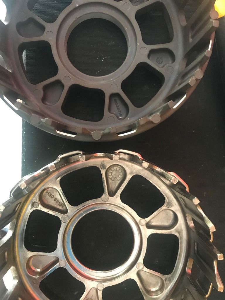

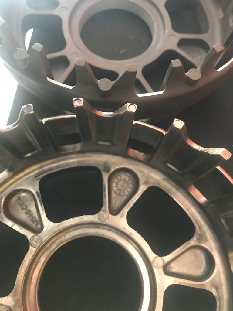

1st Pic , old bottom, new top
From the several pictures posted above, you can see that the fingers on the new clutch are much chunkier and you can see they have a round thickener in the middle of each finger. The the old one (silver) didnt have this. Also the stiffening ring is much thicker and wider on the new one.
The new clutch rubbers come in two compounds, the black is stiff and is similar to the old rubbers and the green is much softer. I imaging this is to give a softer low speed throttle feeling. My F3 originally only came with 6 stiff black rubbers.

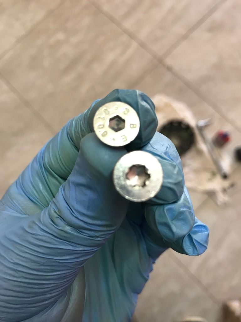

The hex screws holding the cush drive plate are pain to get out as they are locktighted to shi*. I managed to quickly remove 5 of the 6 using a torx bit attached to my rattle gun but the 6th and last one sheared the bit so had to take to an engineering shop to take it out. Use of a rattle gun with torx is not advised and do so at your own risk. The new screws are Hex (thank goodness) and old ones torx (think the MV engineer was smoking something when he specced it like that)

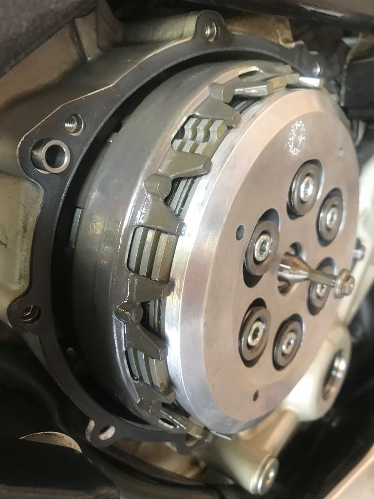

Clutch put together and installed
And last one, buttoned together and good to go
I saw on MV's technical bulletin that it should take 30min to replace which is ridiculous. It took me 5 hours taking it at a steady pace (besides the two days lost due to the issue with the rounded torx bit on the old hub). Think a good mechanic who does this daily should take about 1.5-2 hours.
