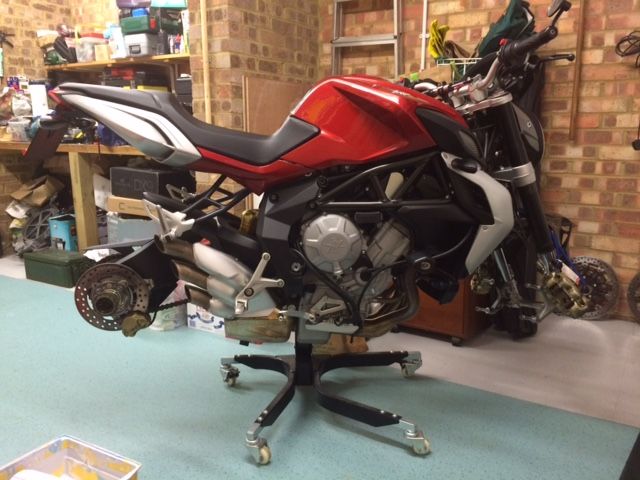

Have just removed the wheels on the brut as it's time for new tyres and gonna get em hydro dipped in carbon fibre. Front wheel removal was as expected but the calipers clear the wheel by about 5 thou of an inch so needed to push pistons back to give a bit more free play. Rear wheel nut was too tight to remove with 3 foot breaker bar (yes I know its a left handed thread) but fortunately many years ago I bought a centrifugal nut runner from argos for £20 and worth every penny it was. It runs off a cig lighter socket and spins up to silly speeds then it works centrifugally and cracks the nut off. No need to hold the wheel to stop it turning. Came off after 3 clicks effortlessly. Well pleased. Cant wait to see end result with carbon fibre wheels and new tyres.

I removed both calipers. Just pointing out that the clearance to get the caliper away from the wheel is minimal.
