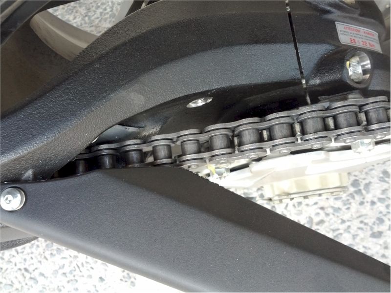

When I got home today i noticed it was leaking here?
Its on the left side just behind the fairing. this got me worried.
And the bolt holing the chainguard? fell off, not so worried about this
Any comforting words for my until I get a hold on my mechanic?

Unfortunately loose or lost fasteners are quite common with new MV’s. I lost the side screw for the same chain guard on my F3 675 while on one of my very first rides.
For the first couple of years I would check for loose fasteners before and after each ride. Any that were found loose twice got the Loctite treatment.

I lost a few fasteners, then went through the whole damn bike with a tube of blue loktite.

Yep I lost the same screw on the chain guard on my Brutale, lost one out of the bottom of the side panel too. Also the two nuts that hold the tank down under the seat went missing, although I think I know where they are, in a box called "petrol tank nuts" at the MV factory

My chain guard bolt went too. Steering damper bolts were very loose after 200 miles. I now check often...
