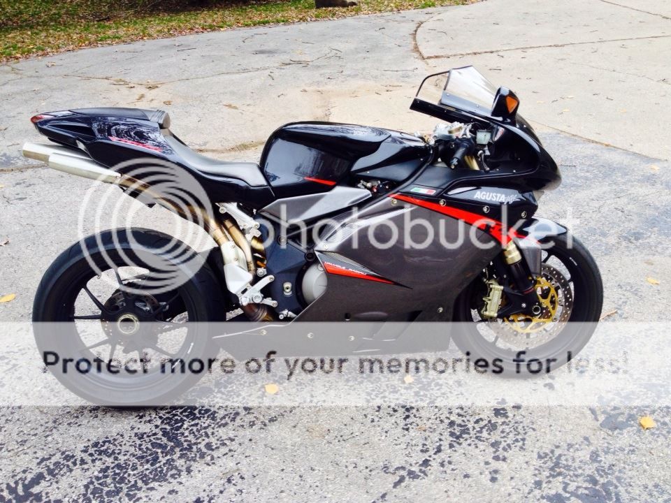

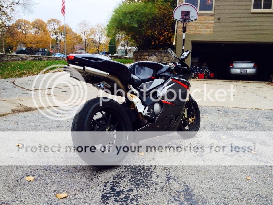

This sounds crazy, but i took the stock one off the fender, bent it with a clamp, and attached it onto the bracket that holds the two pipes together. It worked flawlessly. I used a $5 LED to light up the plate, and ordered an integrated tail light.
It really made the rear end look a lot cleaner!
Best of luck! Happy to answer any questions.

Hopefully you're tyre won't collect that. Not too many places left around here where you can still run a numberplate hidden like that.
On a side note, your bikes a F4 1000R, only the 312 came in R and RR version.
