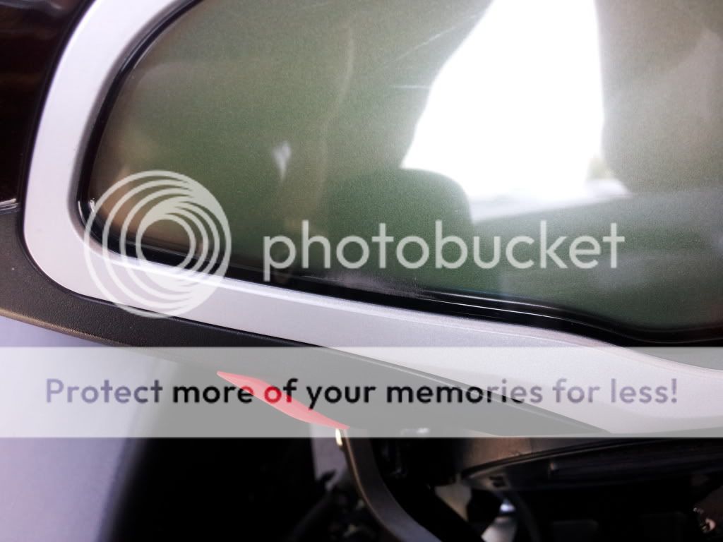

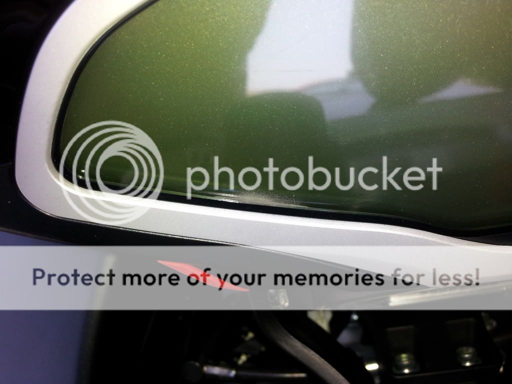

Hey Guys.. Anyone run into this problem yet? Yet another issue.. But the bike is beautiful im not gonna let me get it down.. Isnt stopping me from riding just annoying.. Im sure the dealer will just order me a new gauge..

Hey guys i just talked to my dealer.. They just went ahead and ordered me a new speedo.. If you are having those issues too punisher just go ahead and call your dealer and they will do the same.

I have had the same problem, my dealer told me they have seen this before, apparently the eyeties in there wisdom don't seal the face all the way round which causes the two plastic parts to chaff, he fixed it by removing the face and cleaning the dust off and when replacing the face joined the seals up!
Seems to have done the job!
