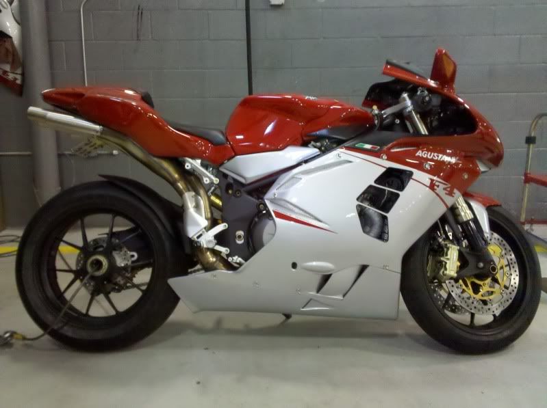

A member here Spypyp did his own vents & his bike looks fantastic - here's a pic - maybe you can contact him & ask him how he did it

I did this mod about a year or so ago. These are fiber glass track fairings and had to be stiffened in the back where the vent was put in. I did it with a sheet of Carbon Fiber., but you can use fiber glass.
If you use the original guards you will not have to stiffen the back side where you place the vent as the original guards are very strong.
The bike runs at a consistent temp of 83 degrees Celsius (181F) and will get to 93 degrees Celsius (199F) stuck in traffic, thats stand still for 4-5 minutes...
The difference with the modification to the guards is the heat escapes very quickly thus not allowing it to over heat...and once you accelerate the temp will drop 8-10 degrees immediately...
These are the track guards and the belly pan is closed, unlike the original F4 which is open.
If you run the Standard Belly pan and do the mods to the upper fairing (extra vents) you will see a difference in temps of 10-15 Celsius (50-60). I have a difference of 20 degrees Celsius only because i run the Microtec and the Bodis Exhaust.
I hope this has answered some questions...anyway here are some pics.

Very nice vents! Not too big or ugly like the vented fairings I've seen for the MV.
