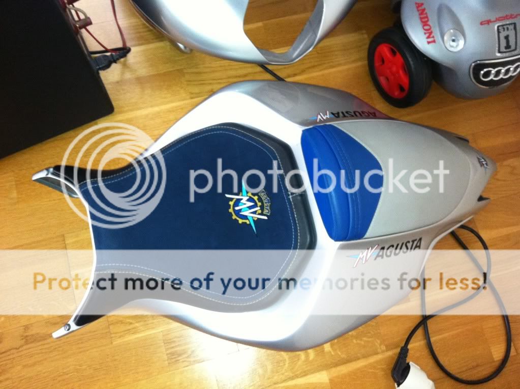

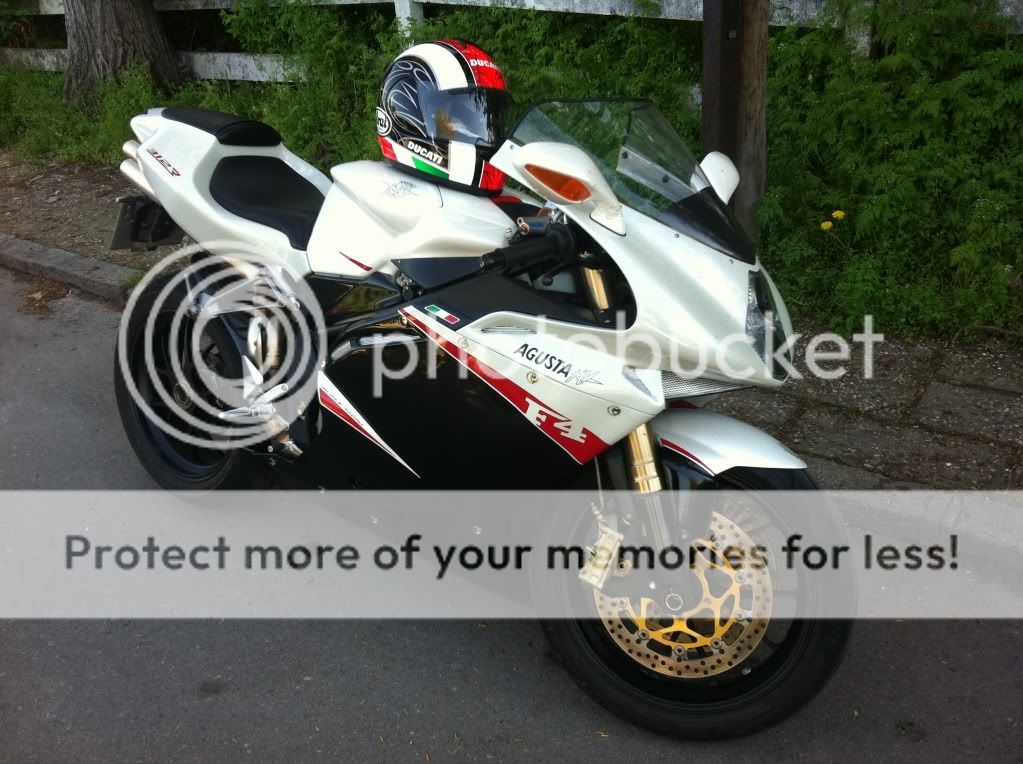

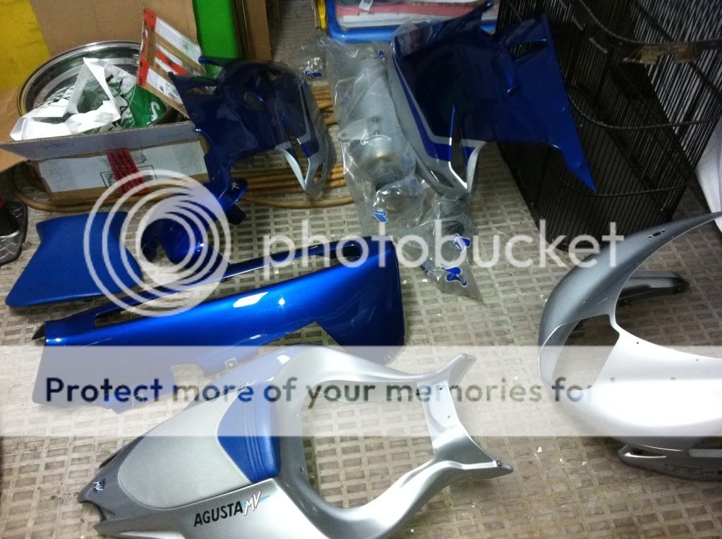

I am going to try to post some pics:
the bike:
A blue/silver fairing kit i am planning to put in the future:
and an alcantara seat that will go with it(the biposto is pending of treatment)

Welcome mate ............ I know what your problem is it's that Ducati helmet sitting on top of the tank.
I have a 312R and mine shakes and shimmies if a Ducati bike comes near it - MV's are very sensitive beasts, you probably should put tape over the word Ducati or a sticker with MV on it and I think most of your troubles will be solved.
Seriously stay out of traffic jams, I love mine and yes it does get hot also look out for a leak in the radiator top left the horizontal tubes will get pulled apart by the weight of the radiators. I fixed mine with some epoxy metal stuff that I jammed into the tubes, no other issues!! I have completed 15 000kms and loved every minute!!!
Good luck with it!
