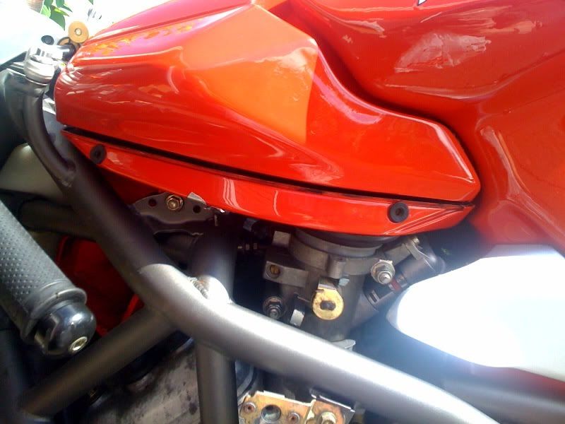

The airbox on my F4 has diveded in two pieces. It looks like its made in two pieces that are glued together from the inside. There are remains of something black in the crack.
What should I use to seal it again? Is it usual that you open up the box like this for some reason?

The best thing I would recommend is to go to a auto glass shop, and buy a tube of their glass weld. It dries to a dense rubber. You could also use black RTV from the local auto parts store.
