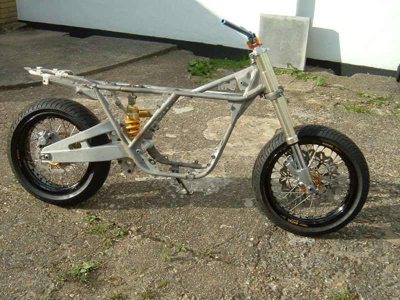

Hi guys, is there any way to stiffen the rear F4 shock, there is an air valve so can I pump it up?
It's this shock, I'm doing up a classic Kawasai triple and it's a little soft

Turn the compression way up and crank in some preload.

Wink TZ 750 Chassis is the way to go for a 500/750 triple.
I raced those MoFu's for years!! H1rs and H2Rs and reckon that shock will bend the frame as its like spaghetti............The way to go is to get a TZ 750 (OW31) Chassis. The kwack engine will fit right in with little to no modification at all, believe me even the engine sprocket and rear sprocket line up exactly.
I raced an H2r here on the IOM a number of times with that configuration and it was wicked!!

This is only a 400 bud, it doesn't have the mental power of the 750's.
I tried winding the spring down with the allen key thing but it only moved like 5mm! is that all it moves?

You'll be way oversprung then!! I reckon an 8.5 or a 9.0 kg spring is what you'll need. (Or even an 8.0)

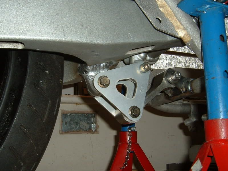

I have the shock attached to a fireblade linkage now and it's just a bit too soft, if the spring adjustment only moves 5 mm is there any spacers I can add to compress the spring more?
Sorry to keep asking questions about a Kawasaki hybrid but you guys have the shock knowledge I need.

Hyperpro makes a spring or two for the MV shock (along with others I'm sure) that will stiffen things up for you. I suggest you look at getting the right spring rate for your project, as the bases for the stock one is surely different then what your hopping to do with it now. This of course is all assuming you have the correct travel to begin with.

Travel is the problem here and only having 6mm of rebound adjustment, I need a shock with a fully threaded body so I can wind it down to suit the project, I'm bidding on an RSV 1000 Ohlins now so hopping to win it.
